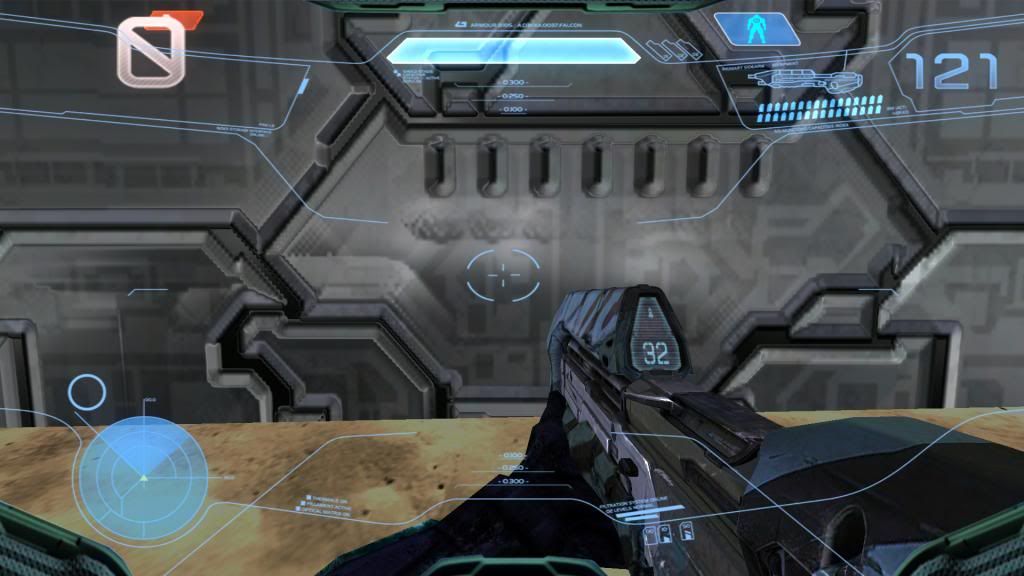

Edit: Well I just did my first in game test of the storm trooper HUD. and wanted to post an update to it so hear it is...
Remember its still WIP. A lot is subject to change. many things didn't turn out like I wanted them to in game yet.
for instance the helmet parts are tented blue. IDK why but it will get a lot better. I hope.
I am also going to move the top part up. and try and open the view up as much as possible from obstruction. and in the end every thing will have a blur anyway.
this is just a pic of the outline some of the alpha channel is not set up yet. sorry.
currently this is what I have.
Edited by jackrabbit on Apr 25, 2013 at 07:49 AM
The shield meter and radar will be red to match and will be moved soon.
Edited by jackrabbit on Apr 25, 2013 at 07:51 AM
Edited by jackrabbit on Apr 25, 2013 at 08:08 AM

I seriously recommend bringing the bottom part of the visor down so it won't interfere.
Liek so:
Edited by Jesse on Apr 26, 2013 at 12:35 AM

Modify the mask bitmap. The closer it is to white, The darker it will be (or was that the other way around.)
Tone down the white around your shield meter and visor outlines, and add some gradients around the visor lines. When foundry is released, you can look to see how I did the zoom out stuff for the visor and weapons.
