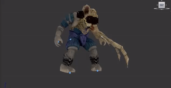

I have been having a blast making these guys come to life with 3ds max. This is just a sneak peak at my tag set which i'm gonna release some day.

No idea why I made this or if I should even include it in the tag set but whatever It know exists. I was feeling bored, stressed and sleepy so I spent about an hour and made this. It is basically just a normal flood elite with the infection form visible. I still don't know if it will be included but i'm to sleepy to think.

Overall the bipeds look really good. Not sure about the H1 infection though as it seems out of place. It'll be nice to see these released when the time comes.
