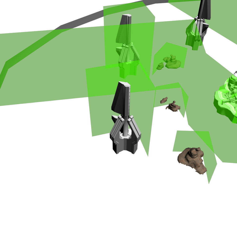

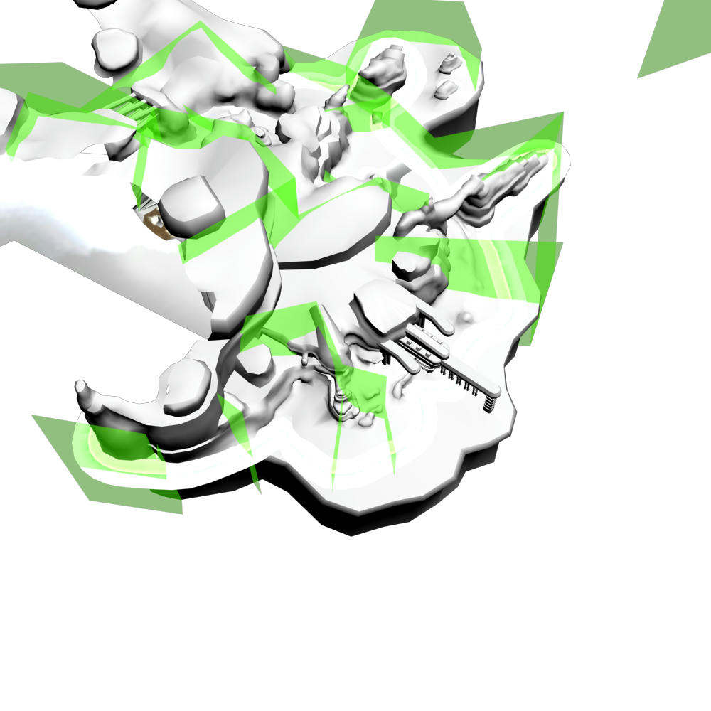

Posted: Jan 9, 2018 03:34 PM    Msg. 4 of 27
Portals can extend past the map collision geometry,
They can cut through geometry inside the map
And they can be doublé side and have there vertexs sold
How ever they are far more effective when you créate faces in the geometry sealing complete the are o part considered as a portal, the engine will automatically discard and avoid rendering that área when not facing it

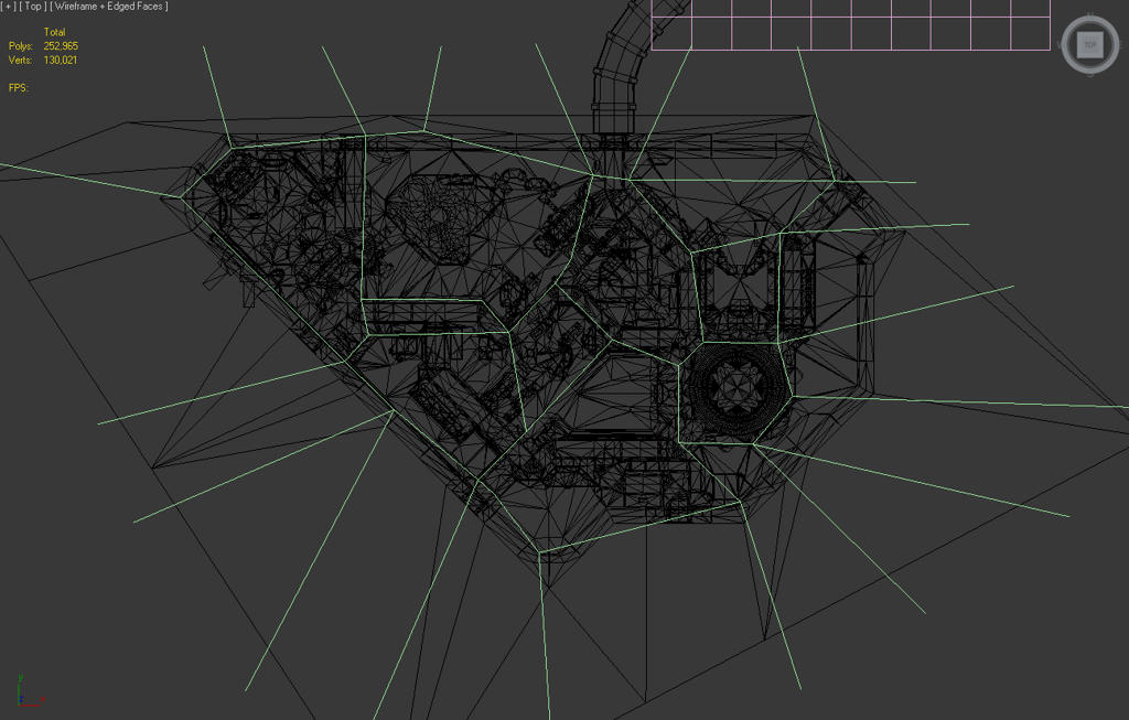

Posted: Jan 10, 2018 12:08 AM    Msg. 6 of 27
https://i.imgur.com/OKcH03d.png
https://i.imgur.com/37WiOKu.png
https://i.imgur.com/19tlXv5.png
Can you list any other maps that are portalled the same way as in your screenshot?
I currently have a rig on my BSP very similar to the one you have there, but I believe I have too few portals. I still need to use exact_portals to close up the interiors, but I'm getting huge issues with the geometry rendering.
This is my most recent one. Geometry is constantly being unrendered; do I need more portals here?

Posted: Jan 10, 2018 05:26 PM    Msg. 12 of 27
Opposite, you have too many within the same line of sight. Personally i try to make sure that i dont have more than 3 portals within a single line of sight because the furthest one will more often than not be culled when you dont want it to. Keep portals simple, and let the exact portals do the heavy work
Posted: Jan 10, 2018 05:29 PM    Msg. 13 of 27
I love you. More, smaller portals has definitely made this worse. Gonna keep trying.

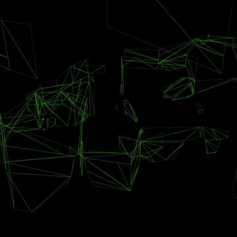

Posted: Jan 22, 2018 10:15 AM    Msg. 16 of 27
Quote: --- Original message by: il Duce Primo
Deadhamster, let me guess you have nearly coplanar warnings. Usually those plus portals can create some funky rendering issues. Try fixing some of those nearly coplanars before working on portals.

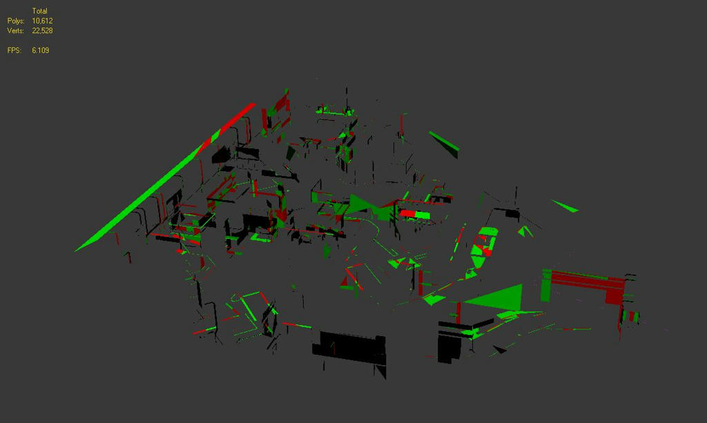

After deleting all the helpers and the few portal errors, here's the .WRL error geometry for the Financial District BSP, the one up above.
There's over 1000 objects there. Again, that's after deleting the helpers. Do you bychance have some magic way of fixing coplanar surfaces that doesn't involve taking each vert and adjusting them? I mean that without sarcasm, is there any magic tool 3DS has where I can make this not take several weeks.

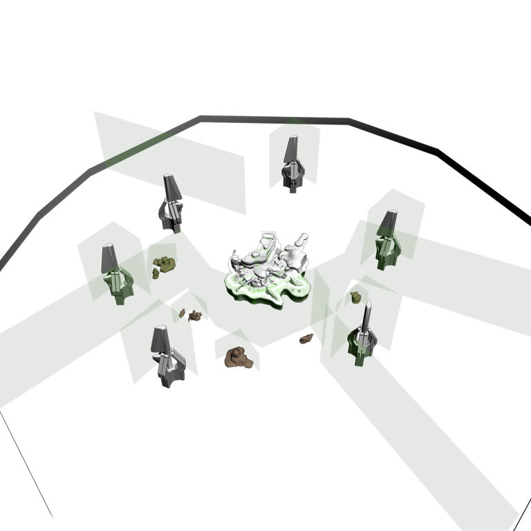

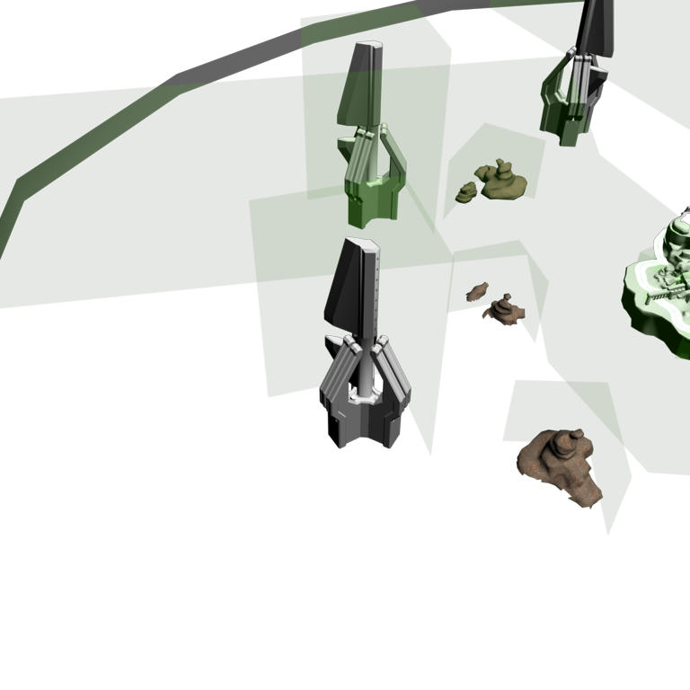

Posted: Mar 15, 2018 11:36 AM    Msg. 19 of 27
Import the stock mp BSPs since they have actual portals that work.
I think i'm doing something wrong
Posted: Mar 15, 2018 12:28 PM    Msg. 20 of 27
https://i.imgur.com/x58qd9x.gif
The MP BSPs have portals? I never even really bothered to look, I've spent most the time looking at SP maps or custom levels.
But yeah those are the same types of issues I've had. I recommend LESS portals, and using them to section parts of the level. The standard grid-terrain portals are actually pretty terrible, especially for any tall buildings. Portals should be behind the surface of a building, not outside it. Portals should not disect a road in half, a long line of sight requires less portals if you want it all to render. Otherwise the cluster 3-4 away will start culling.
So for that road, that road should be one single portal going down it's entire length. The building popping in and out could be fixed by moving the portal further left so that's it's behind the surface of the building.
If you have distant geometry in the background as decorations, cover them with a box of portal planes. As long as the player is looking towards that box they will all render. Look at how B30_Evolved's decorators were portalled out in the ocean for example, the towers and rock spires each have their own personal cluster.
The biggest thing to further help your scenario; Take your current grid portals, drop them so that the top verts is just a bit over the playable area of the map, and add a "roof" of portal material to connect the ceiling so that the top of the portals are inside the BSP and sealed.
Now when portals are rendered, the tops of the buildings will all be in their own cluster group which is viewable from anywhere. The playable area of the map is still sectioned off and details you can't see will be culled, but the tops of the buildings you can see from a mile away still render without being culled.
I've learned that you don't want to use terrain portals. They're not very good, exact portals work far better. What terrain portals are useful for seems to be sectioning off large parts of the map. Unfortunately, Halo isn't very good at this when we're talking a large open environment like the kind we're making. Halo was meant for grassy hills and indoor environments, I can see why they scrapped their E3 map. Would've never made it on Xbox hardware.
IF ANYONE KNOWS WHERE SUPER FLANKER IS, SEND HIM TO ME.
He seemed to know a bit about portalling BSPs. Alternatively, if you know anybody who is more knowledgeable about Terrain Portals than myself, I'm at the point where I'm willing to pay smallish amounts of money for somebody to properly portal one of my levels and explain why they did it that way.

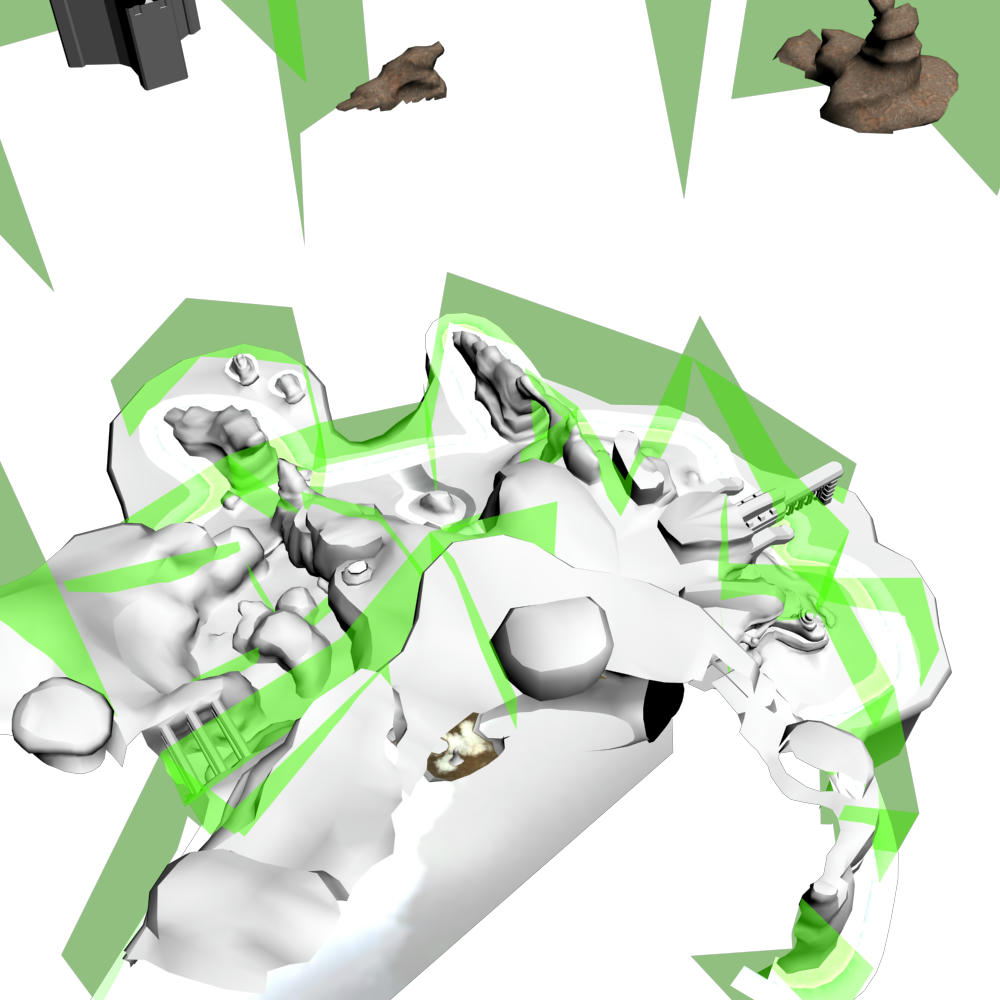

Have you seen the portals done by the TSC:E team?
Seraphim -
no i haven't, but i've heard they're einstein levels of complicated
DeadHamster -
They box everything out and use a ton of extra vertices. Which is extremely similar to how it's done by Bungie in the default TSC level
Seraphim -
if you could send me a picture of that, it'd be great so i could try and deduce how important the normals are
but if you can't be bothered that's totally fine, i have the files
DeadHamster -
By boxing out the playable area of the map, and facing the normals inward, it would only cull playable areas and not the cliffs
so the cliffs won't be culled which the player can see from a distance
and they use a TON of portals
getting screens now

there's an overview
so see how they box out the things way out in nowhere? the decorators?
normals face inwards
That would make them always show, no?

DeadHamster -
I believe that clusters get defined by inwards facing +portal planes, and that you can view clusters close to yours
Overview of the whole exterior.
They regularly use volumes with over 4 sides
and less

DeadHamster -
That's a wireframe of CMT's portals.
DeadHamster -
But as per the wireframe, notice that they have verts in the middle of portal faces
Portals when compiled will get marked down to the simplest possible shapes, per Moses
so long as their convex coplanar blah blah blah
