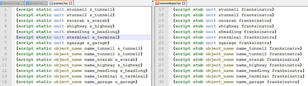

Quote: Stub
Allegedly a "prototype" script.
Has one useful function to define a player directly (so you do not
have to reference the object_list to the player in every command
every time you try to look for the player)
(script stub unit player0
(unit (list_get (players) 0))
Not quite; Stub scripts operate the same way as Static scripts, however if a Static script with the same name is compiled alongside it, the Static script is kept and the Stub is left out.
CMT uses stub scripts for debugging purposes, to make a "prototype" script like this;
(script stub boolean random_chance_50
(print "UNFILLED STUB: random_chance_50")
false
Then later in the document or in another script they'll create a static script with the same name. It overwrites the stub, if there is no static script a debug message appears for the dev team letting them know they forgot to write a script.
(script static boolean random_chance_50
(> 0.50 (real_random_range 0 1))
I don't quite understand the benefit, but on a project as big as SPV3 with Kirby adding engine features through blamscript, I guess you want to just lay it all out beforehand.
I found a much better use for them; Child Scenarios;
When tool compiles Child Scenarios there is no hierarchy, there is no parent or child scenario. It makes one, single scenario file out of all of the pieces. Which means that a stub script in one scenario can be overridden by a static from another.
For example, I keep a scenario file only for scenery and vehicle placements in Mombasa. I can name the vehicles in that child scenario using a static script, then put stub scripts in the main scenario that reference dummy objects.
When the map is compiled, any script in the main scenario's .HSC that referenced the dummy objects will instead reference the vehicles from the child scenario's .HSC
/threadjack
