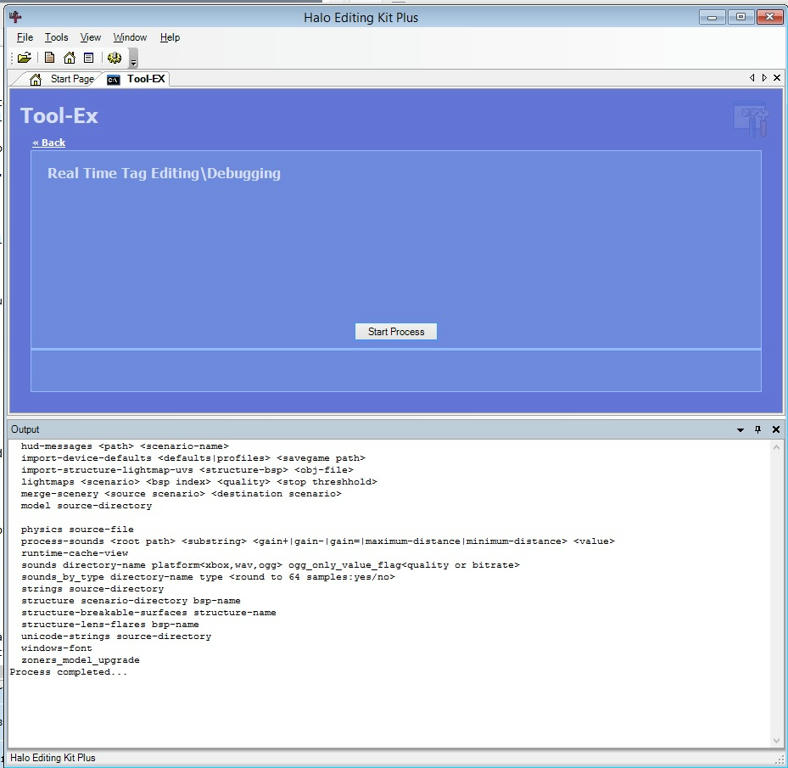

Screenshots.
This makes it really easy to compile your map with memory upgrades with one click.
I use it constanly.
Just Leave the mod name blank and choose yes to memory upgrades!
I leave my program open with the senario directory set and make tag edits.
then when im ready to test i simply click start!
so simple!

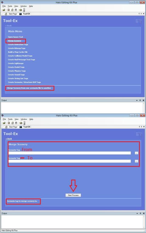

optional tool ex Merge Scenery new main menu item addon!
okay I was looking through the code to see what we might need to not need tool at all and i notesed the merge scenary fuction was missing in hek+ so just today I wright this.
and I need someone to test it out!
this should work in os_tool or tool!
this is not part of the open sause arguments this adds another function in the main menu called merge scenary I need someone to test this!
<MenuItem Text="Merge Scenery" Description=" Merge Scenery From one .scenario file to another">
<FileItem Text="Scenario Tag" Name="Scenario" Filter="Scenario Tags (*.scenario)|*.scenario"
Description="Scenario tag to Merge Scenery from." />
Description="Scenario tag to merge scenery to." />
<Tool Arguments="merge-scenery [Scenario] [Scenario]" />
</MenuItem>
Edited by jackrabbit on Oct 27, 2013 at 12:01 PM

I think I have figured out how to make a real time tag editer with gui
actuly editing the tags wihle in game will make map making so much more fun for everyone it might just get the community back on its feet
yeah I cant beleve how fast I wright that new command in hek+ this moring
the first one take me a week that one take me 10 min's now this!
I think understand the lang just need to learn some of the missing functions.
now I am trying to atempt to wright the code for the real time tag editer
this one function will make hek+ so useful! combineing kornman00's os_tool with firesyth's hek+ +kirby422's scripting abbilitys.
I have not a whole lot of real time tag editing my self only wached kirby422's video & shadowspartins real time tag editing app that he desided not to release. So I really need you guys to give me some input & make sugjestions as to what the layout needs to look like? as far as textblocks, options & functions we need in place?
What do you want to see in a real time tag editer with gui?
I'm not sure if this is even possible but it's deffenetly the way forward in halo development. this will help make maps & tags so much quicker. I'm quite sure!
Edit: I am tryign to get hek+ and os_tool to play nice with eachother but all they want to to is battle!
I need some help!
if anyone knows how to clone a SOURCE of OS 3.0.1 ON GOOGLE CODE PLEASE LET ME KNOW.
the onyl chage I need to make to the project is the OS_tool argumnet.
just needs to be tool. pretty siple change to the code.
hope someone can help with this!
