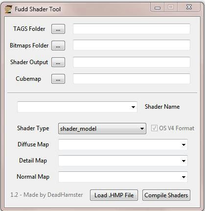

Fudd has been updated to version 1.2
Download Link

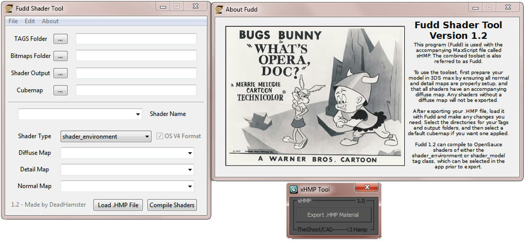

With this update JMS+ has been replaced by xHMP, a new maxscript exporter that does NOT export JMS files, only the HMP material format.
This format is used by Fudd to compile shaders. Fudd can only compile two shader tag classes; Shader Environment tags and Shader Model tags. Both tag classes are in the OSV4 format. You should select one of the classes before startup to choose a default, and then you can manually reassign each shader once they've been loaded.
xHMP and Fudd 1.2 also has support for exporting and compiling detail maps, normal maps and to a lesser extent cubemaps. One user-selected cubemap is used for all shaders being exported, and individual changes must be updated manually in guerilla later.
The maxscript plugin is designed in 3ds Max 2010, and you may experience issues if working with newer or older versions of the software.

Edit: Patch 1.1 for xHMP has an enhanced UI, loading and exporting should both be quicker now. The enhanced UI displays all the materials and bitmaps loaded, allowing a user to verify any errors in their setup prior to exporting.
Patch 1.1 also has two bugfixes. The first corrects shader symbols for double sided surfaces ( % ), which would cause a crash. The second corrects handling of textures without diffuse maps, which would cause an incorrect number of materials to be passed on to the .HMP file, causing Fudd to experience a permanent loop hangup. xHMP currently ignores exporting any materials which do not have diffuse maps. A future update may look into a fix, but this would need to be packaged with a Fudd update as well.
