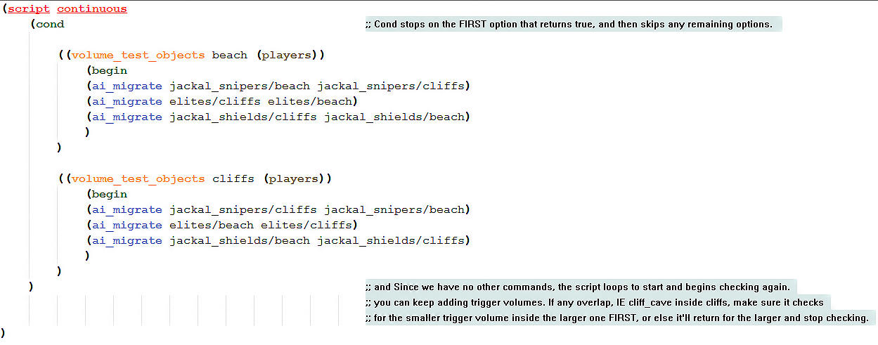

This separates different functions. I might have mixed some up, but the general rule of thumb is;
Red- Script startup lines (script, global, startup, dormant)
Green- Script functions (sleep, if, begin, cond, set)
Blue- Game Functions (ai_place, object_create)
Orange- Return Functions (unit_get_health, volume_test_objects, device_get_position)
Brown- Variables or Object Properties (vehicle_name, short, object_list, trigger_volume)
Purple- Inherent Values (True, False, None, Void, Min, Max)
This makes breaking a script apart much easier, as each part of the script is sectioned off from the rest by obvious color differences.

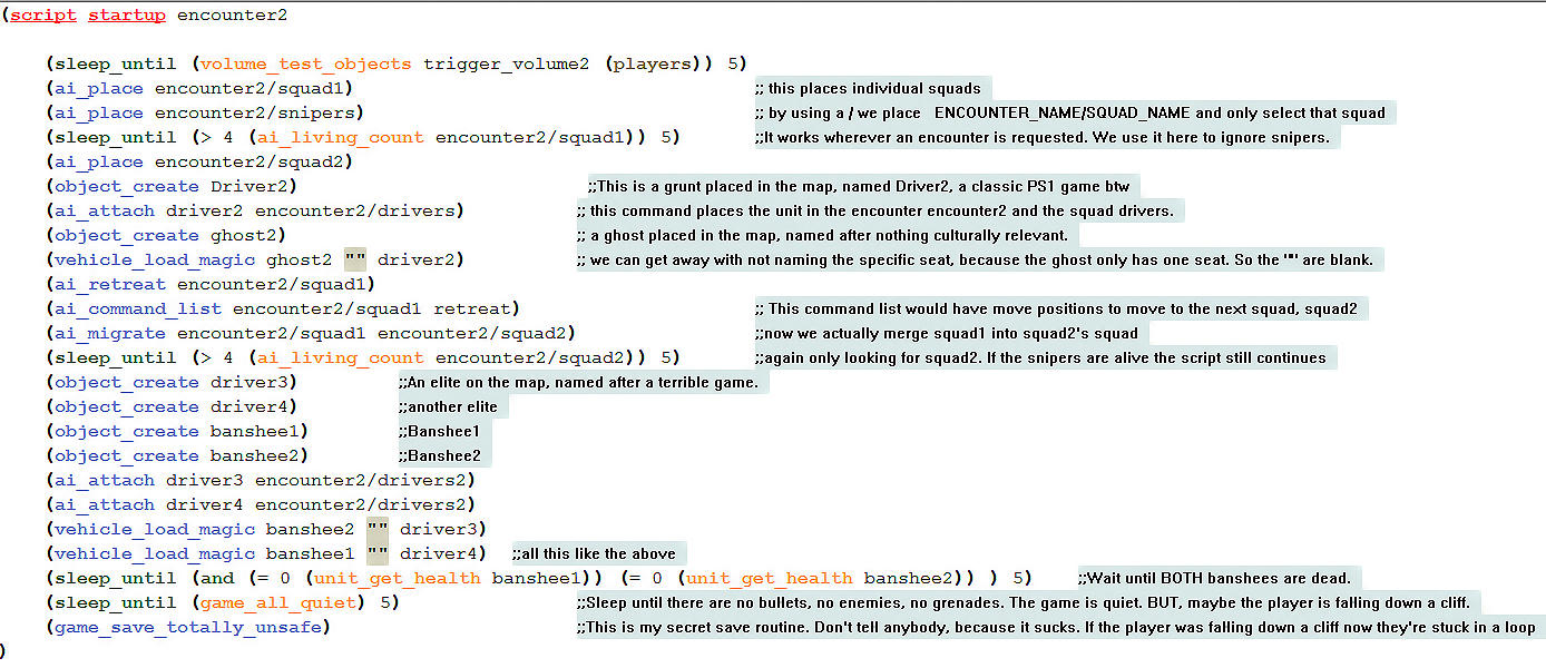

But, again, you shouldn't be using (sleep_until (= 0 (ai_living_count encounter))5)
You should be using something like this
This waits until the AI are almost dead. Then it makes them retreat, or call in reinforcements. The AI in the game are all different, and should be treated as such. Not even an alien army is fearless of death; grunts should retreat, jackals regroup to higher ground. You can use trigger volumes to read how the player is moving around the map, and then run something like this based on where the player is;
This checks if the player is either in cliffs or the beach, and moves the snipers away from him and the elites and jackals towards him. This is assuming you have two squads made, where cliff AI has firing points around some cliffs, and Beach AI has them on the beach. Or whatever, not limited to cliffs and beaches obviously. Just concepts.
Also, instead of just checking for one variable (AI being less than 4), why not two?
(sleep_until (or (> 4 (ai_living_count encounter)) (= 0 (ai_living_count encounter/elites)) 5)
That will sleep until either 4 total AI are left, or both elites have been killed, sending their subordinates into a panic perhaps. Or maybe, having given up hope, the grunts perform a suicide rush with grenades. Or maybe at that point Krypto the superdog descends from the heavens and bites the master chief square in his crotch. Only you get to make that decision.
