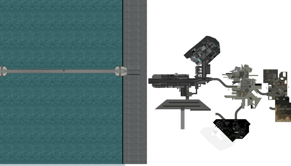

You COULD swap the BSP and then teleport the player to a flag placed inside the new BSP.
But, the proper way is to create level geometry in BOTH BSP sections that overlaps. Basically, create a tunnel that connects both ends, and copy it to both BSP sections. That way when you swap the BSP, the section the player is currently in is inside BOTH of the bsp sections. It appears seamless to the player that the level has loaded.
See the picture below?
I use tunnels to connect each individual BSP, and those same tunnels are cloned so that BSP 1 and BSP 2 both have the tunnel that connects them. Then, look at my response to your other thread to see how the switch works.
